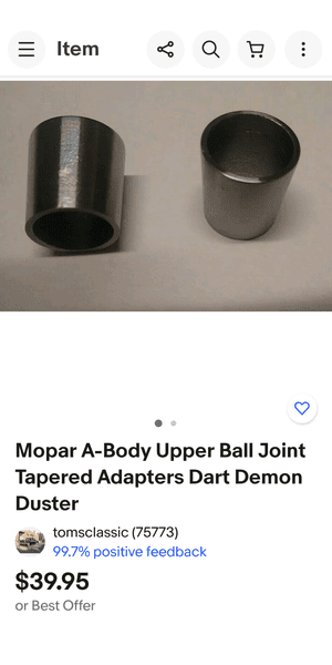

Who here has used them ? I am thinking of going that route on a 71 demon that i am working on for a guy. Even with buying and installing new ball joints & bushings it will still be cheaper than buying 73 & up A bodies arms
Who here has used them ? I am thinking of going that route on a 71 demon that i am working on for a guy. Even with buying and installing new ball joints & bushings it will still be cheaper than buying 73 & up A body or FMJ body spindles.
I'm confused . What spindle are you using?
I've used them on a few builds.
They're great if you've got good arms and as many have already replaced the ball joints previously, they are cost effective .
I was uncomfortable with the nut arrangement, so I castle-ated the nut with a hacksaw, and drilled the joint for a cotter pin.
I am sure many have been used as is, I just go the extra .

would you happen to have pictures
Mopar A-Body Upper Ball Joint Tapered Adapters Dart Demon Duster | eBay
