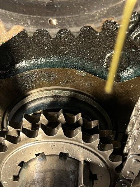

To get the cam closer to 107 intake c/l you would move to the -4(or R4) setting on the lower gear.
The -4 slot goes over the key, and the dot on the upper gear gets lined up with the other -4 mark on the lower gear.
Then recheck the installed position.
I'll add this as I fixed a number of engines that those 9 ways got messed up when installed.
People move the crank keyway to the triangle, then don't line up the tooth mark triangle with the cam gear. They roll the engine to the "o" dot. That will make a mess of things.
This is exactually what I did earlier before I posted my question because I wasn't sure it would be correct procedure!
The result I achieved was an intake 106.5 CL, so I guess I was ok.

After checking it again a couple of times to satisfy myself I used loctite Blue on the cam bolt and tightened it to torque value and once again checked it 3 times starting with setting PTDC and the final 3 sets of numbers were
.213 .214 and .2135 which gave me an average of.10675.
