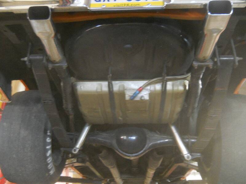

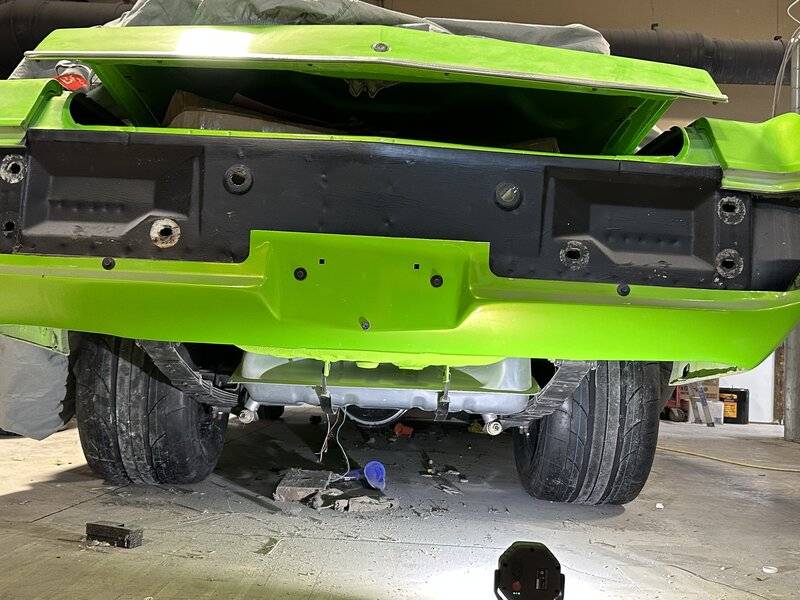

im finally ready to start this on my 68 barracuda.
can i keep the stock gas tank?
will it clear?

yes......we are not lowering the front but want the back way up to clear some monstersWhy are you lifting it? Don't tell me your also lowering the front for the superstock look LOL. 12 inch wheels fit under with 28 14.5 15's . If your using SS springs they take B-body bushings with that kit. Springs and weld in pipes. Make sure your springs take the same bushings as the pipes they fave you. the kit should have come with b-body shackles
I got 29 x 14.5 tires under my car without lifting it. 12 inch wide rims with 7 1/2 back space. Also have 315 drag radials on the demon with same size wheel. My personal opinion, I believe lifting a car is stupid. The tire diameter lifts it enough. The demon has bigger tires and was lowered 4 inches. It will go down once more weight is added. Lifting the car makes it harder to control on the big end if it starts spinning. Both cars have 3 inch inboard kits.yes......we are not lowering the front but want the back way up to clear some monsters
