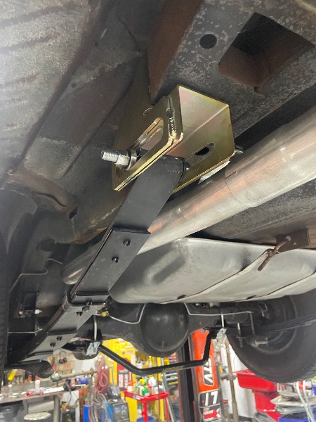

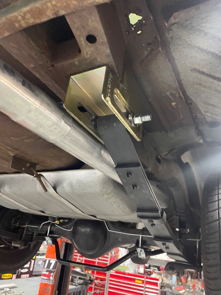

Installed
Do You have a bracket that moves the eye up close to the top to lower the car, in conjunction with flipped or raised front hanger mounting points? Also, those bearings appear to be against the slots up front w/the springs unloaded. Is this limiting the total drop intentionally, or something that can be adjusted with shims(available?),...in case full drop would be a common occurrence?
The front eye has 2 positions. The upper will lower the stance. The slots in the slider bracket are long enough for a flat pro touring type spring and a more arched drag spring. Typically, the droop is limited by the shocks.

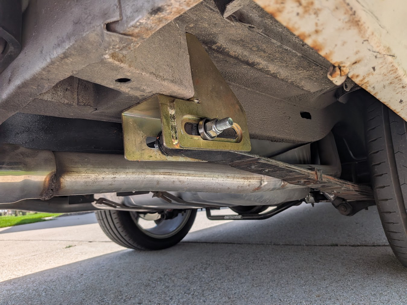

I put mine on over the weekend:
My car previously had the MP Offset Shackle kit since 2009. I ended up welding up the slots I had to cut in the framerail from then. I didn't have to change out my spring pads, the locating hole was actually oversized so the small ~1/4" per side difference was just taken up by the hole. It actually looked that the rearend was probably 1/4" left in the car the entire time before I put this kit on.
The only thing I found is that my ESPO springs from 2002 have the larger spring eye bushing than the kit is designed for so I put it together with my existing polyurathane bushings, which didn't seem to be a problem. The bolt size is shared with the MP kit. You might want to check your springs first if you don't already have the large bolt.
The spring definately sits a lot flatter, you can see the scratches and dents from my trip last year on power tour when there was a lot of weight in the trunk and the leaf spring clamp rubbed it. It clears fine now. I wasn't expecting it, but the car rides better now. Only put about 10 miles on so far to re-check the bolt tightness but so far I'm extremely happy.
Glad it worked out! I've sold out all my complete kits. Most A bodies had 1.5" bushings which is why these were designed this way.
