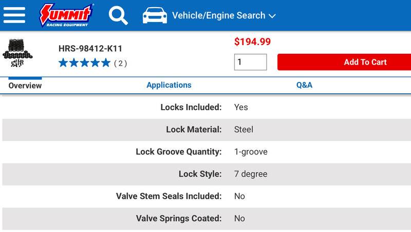

Will the Howards 98412-K11 kit fit the stock 7 degree valve locks? I really want to keep the original 4 and 2 groove valves.
It says single groove.
I would want to measure the valve stems to make sure you get the correct size keepers. You know that kit runs a 7 deg keeper. Just need to determine the valve dia and the number of grooves. Trust but verify is a good moto. I would want new keepers, they are just cheap to replace.
