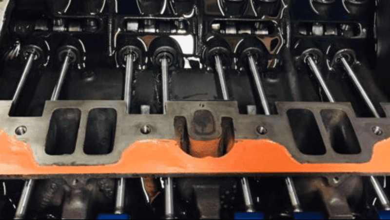

I just did some research and found out that the big block pushrods push on an angle up to the rockers. I never knew that. Looks like about 3/8 of an inch offset. This would push the rocker side to side. The small blocks don't have that problem from what I see. They are perfectly straight. The small block would not have that problem. I don't think that the side play will be that critical compared to the big block setup. Someone correct me if I am wrong.

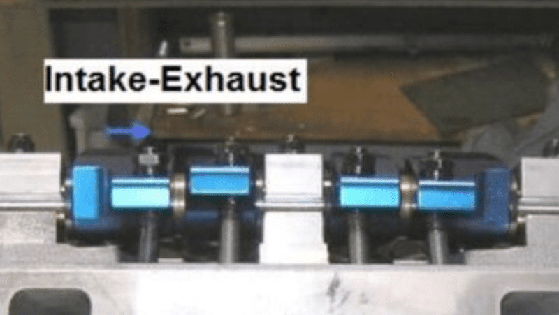

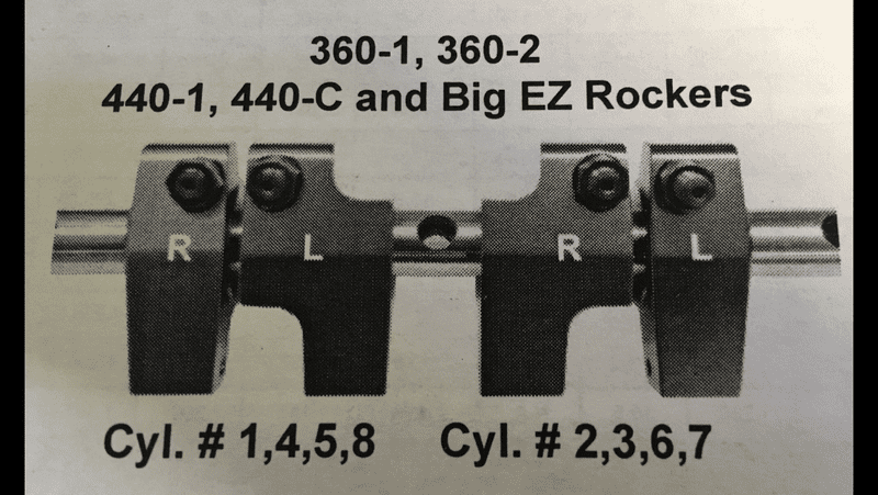

That pic of the BB is of Indy heads, which use heavily offset intake rockers.
The factory BB rockers have a slight offset, which is there to allow the pushrods to be straight up and down.
Additionally, in that pic, the exhaust rockers are in the wrong positions. They would normally be swapped left to right so that the ex pushrods would be straight up and down.
The adjuster screws should end up next to each other.

I was just pointing out that BB's are not exactly straight and SB's are perfectly straight. So side play is not as critical. Just wondering if 0.030" side play for example would be a problem in a SB.
No, they are not. The small block has a FAR greater pushrod angle than the big block ever did. Look at the pushrod angle from the FRONT. It's ridiculous.
