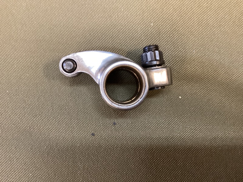

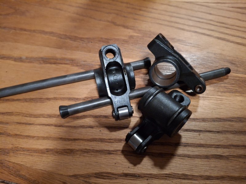

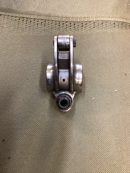

These are the old Comp Cams before Stainless and not Bushed. 1.5 ratio will be used with the 3/8 pushrods(shown)
And Bannana shafts and adjusters/nuts came from Smith Brothers

Seems like the tip of the PRW is much higher above the centerline of the pivot than the Comp that is pictured below it. Especially if the rocker is rotated so that the adjuster bolt is vertical. That has to have an effect on something? I need to get my set of PRW out anyway to start measuring again for correction. If someone has good Paint skills, I bet it would be more obvious with some reference lines laid on top of the axle axes.
It was obvious to me when i first looked @ the pics, that one is higher. & there was one that seems to look even higher than that, but may be has a different shot angle on it fooling me.
There are certainly differences in the shape of the arm and in the angularity of the adjusting screw. It’s a little harder to tell anything about the differences in the location of the contact points which is what would really matter. Does anyone have an old PRW rocker (1.6 ratio) they would be willing to ship to me for comparison testing? I have block and head combo still set up for this purpose. I’ll pay for the shipping both ways and post the results.
