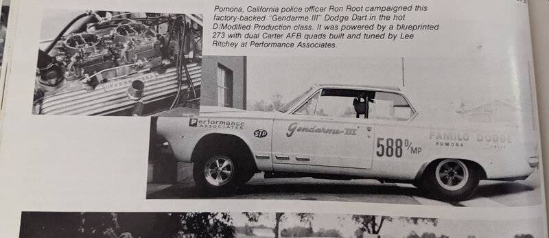

Is anyone here old enough to remember what D/Modified Production cars ran in the mid 1960's? Did they run flat tappet or roller cams in M/P back then? Found this pic in an old book and though it would be cool to build a tribute engine. Just wondering what the performance potential might be. I have a 273 core but might use a 318 just b/c it's easier (cheaper) to get a set of forged 318 pistons. Not really interested in making it a 360 or a stroker.

Seems the one big difference between the general D/Dart description above and the Ron Root car from the magazine in the first post is the dual quad intake.

I want to build a similar looking engine for my 66 Barracuda. Already have the intake and valve covers, just kind of curious as to what these (D/Modified Production) cars ran back in the day to have a number to shoot for. No strips around here and the car isn't nice enough for S&G's, so just a fun weekend street ripper.
The only things the same on the Roots engine and a D/Dart engine would be the connecting rods. The Roots has 12.5 pistons, higher lift cam, different crank, larger valves, heavier duty valve springs, lightweight fan...... And they both run around 12.92 @ 105.
