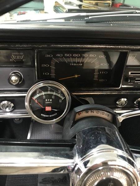

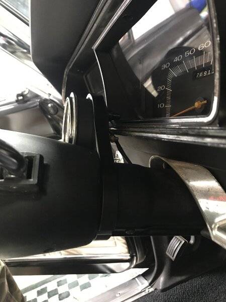

Finished product. Gave up trying to get the convertor box working and paid for an original sending unit.
