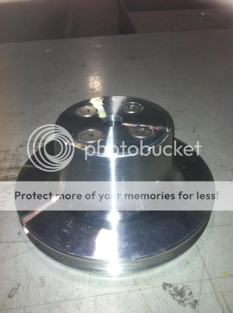

I have a big block in my 67 dart. when i put my alum. rad in and the electric fan set up i had the water pump pulley bolts were darn near rubbing. I counter sunk the pulley and gained over a 1/4" clearance.
i used 2 electric fans, one a 12" and the other a 10", diagonally on my aluminum radiator so the center of the water pump was inbetween the two fans.
