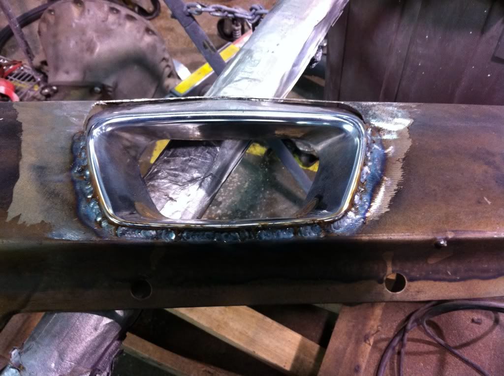

Don't have any close up pics (that I can find) of my welds.
Built and welded a few things over the years. Such as an entire dumpbed (from scratch) for one of the old work trucks, a pair of tube bumpers (With winch mount) for my D50, another tube bumper for the rear of my dakota.
The worst jobs ever were the ones where I would be on my back, underneath a bulldozer, welding upside down with an antique farm welder (to fix my uncle's dozer when he'd break something)... "I smell skunk....oh wait, that's just my hair burning..."
I will never claim to be a good welder however I can make 2 pieces stick together.
Doesn't look too shabby. I work in what is considered one of the best weld shops this side of the Ol' Miss and some of the beads I've seen from some of the guys that work here, well, umm uhh :puke:
Others say they should seek another profession and can't believe they were hired in.
I've got a buddy that does industrial welding and fabrication he keeps telling me to get out of cars and come work with him however I don't know how to tig.
