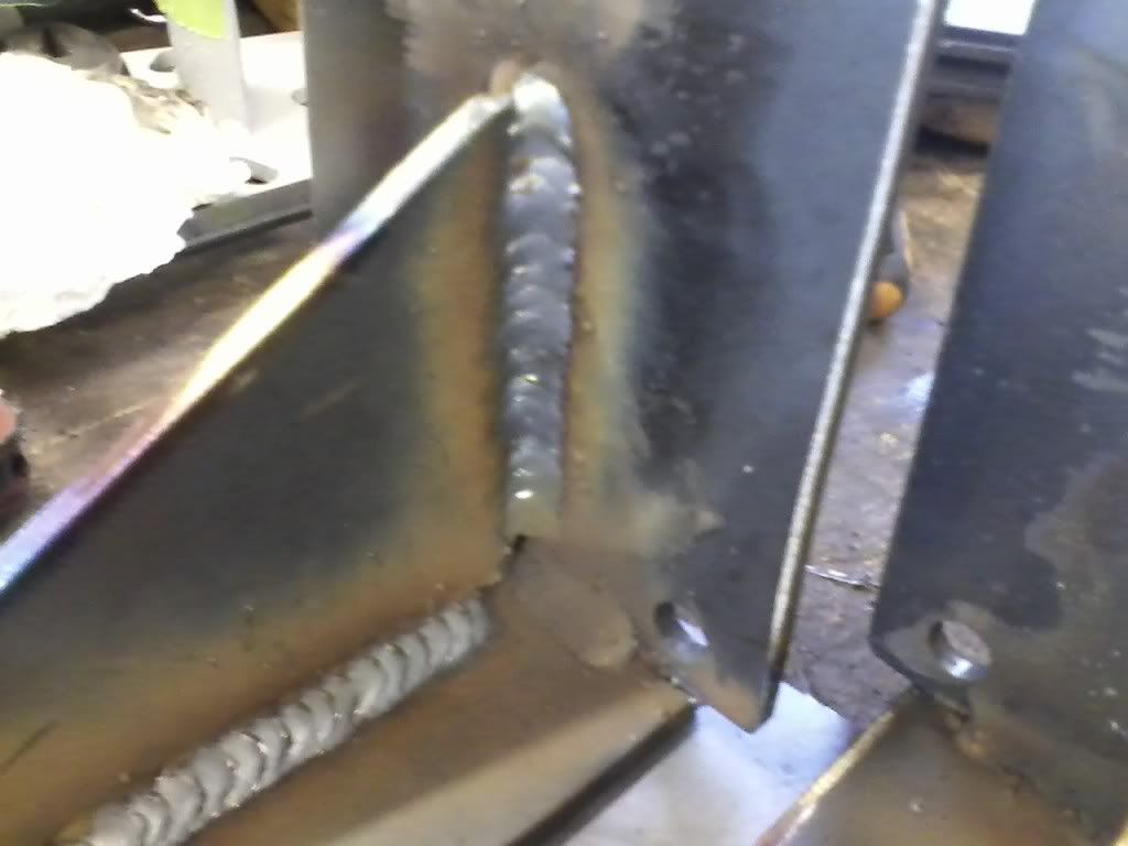

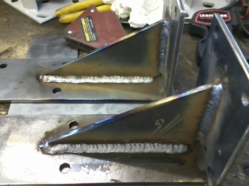

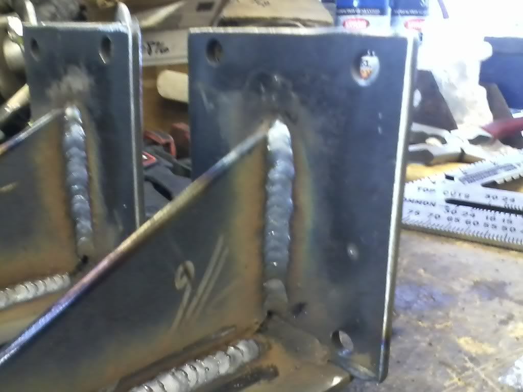

Some pics of today's welding. One weld is a continuous 1/4" fillet from flat (in position) to uphill (out of position) without stopping. Not to brag but I'm only one of a few in our shop that can do this without having to stop after the flat and adjust my welder to weld the uphill. Most guys stop to lower the volts/amps to weld uphill....not in my house, lol.
Other pics are of a multi-pass fillet that's supposed to be 3/8" in size. I do em in 3 passes. They end up being more like 7/16" but in our industry bigger is most of the time better because it really sucks having to add weld and blend it in with a grinder....ucky!!
Nice welding SRT8 Dart
