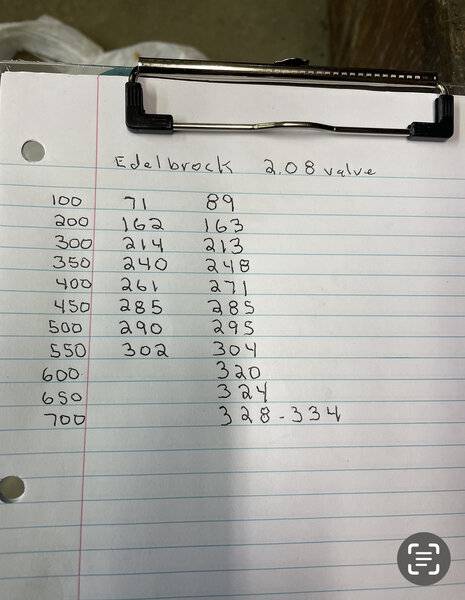

A better set of Edelbrock heads with a better valve job and things I’ve learned the past two years. They’re flowing this right now but I have a few more thing to do.
