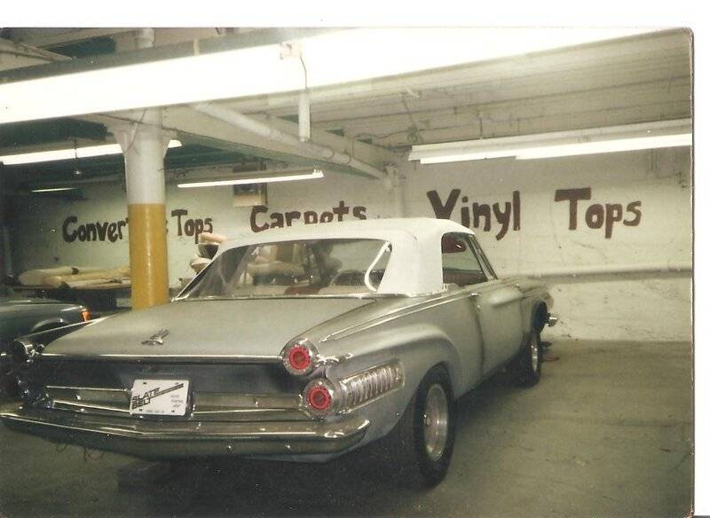

I did mine with help from and interior shop. Many tricks that differ as you install the top. One thing is the top is not all the way down to allow for stretch. Old timers are the best at this. The best advice I can give is find someone with experience, Once you screw it up there is no turning back.

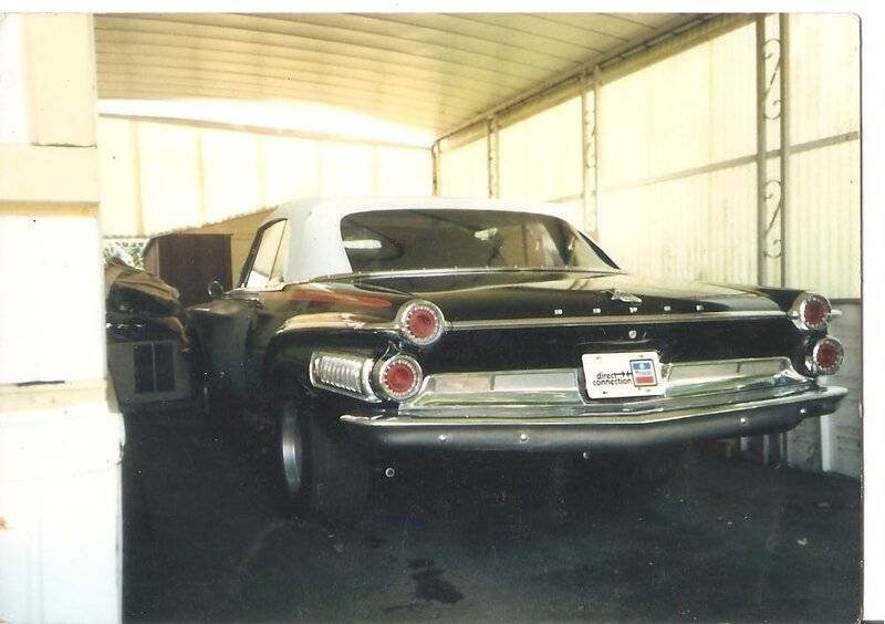

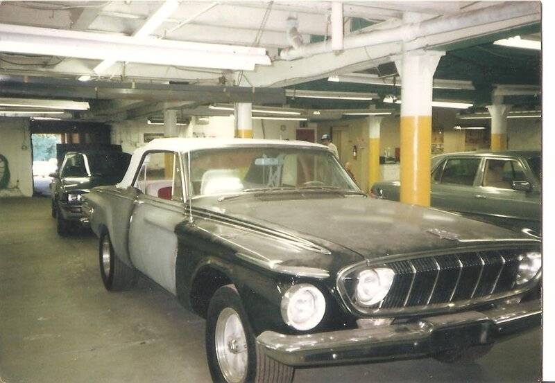

I used the 65 FSM to replace the top on a 65 Coronet I once had. It actually turned out very nice with no wrinkkes
  1. Basically the bows are adjusted per the FSM
  2. the two side strips that go from the header bow to the rear most bow.
  3. Then the rear curtain
  4. Then the top.
There is A LOT more than that and I second get help from someone who has done it before.
In 67 the rear curtain attaches to a tack strip that is screwed to the body, you can not adjust the curtain with the tach strip attached to the body and you have VERY limited numbers of attempts till you have cut too much of the curtain off or poked holes in it from staples.
