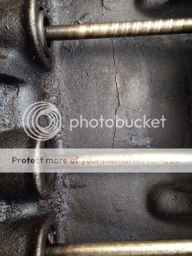

Could be worse! This I the lifter valley on the 400 block I recently picked up
? Orientation of cracks? (seems I remember this photo from another thread ???)
I.e,
Right Bank, Left Bank, forward Block half (from #3 cam journal) or rearward ?
