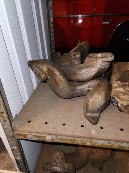

6. My core I bought came with a set of A-body big block exhaust manifolds. From what I've read these are about the best fit option out there but do limit the performance. If they will keep me from being able to get to that 400ish HP mark, then I'd likely sell them and put the money toward a set of the TTI headers.

Sorry, but you will not meet your 400HP goal with factory "A" body manifolds. Originally they took a 330HP 383 motor and put those manifolds on it for "A" bodies and it knocked it down to 290HP. With what those manifolds are bringing, you can buy headers. Good stock heads can work if the combination is right.

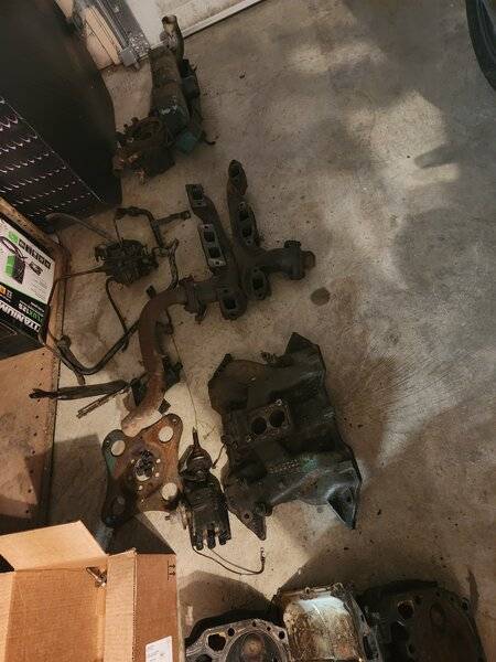

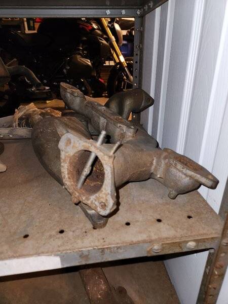

The ones in the picture (of everything spread out) don't look like BB A-body manifolds to me... but the real thing is going for low four figures (383) and even more for the rare 440 ones.
Are you sure someone actually gave a pair away with a core engine? If so, sell them and you can not only buy headers but some other parts too!
You're correct. The ones on the floor that came off the motor are not the ones in question. The a-body ones are on the shelf.
The third one way down on the bottom shelf is a 273 driver side unit.
