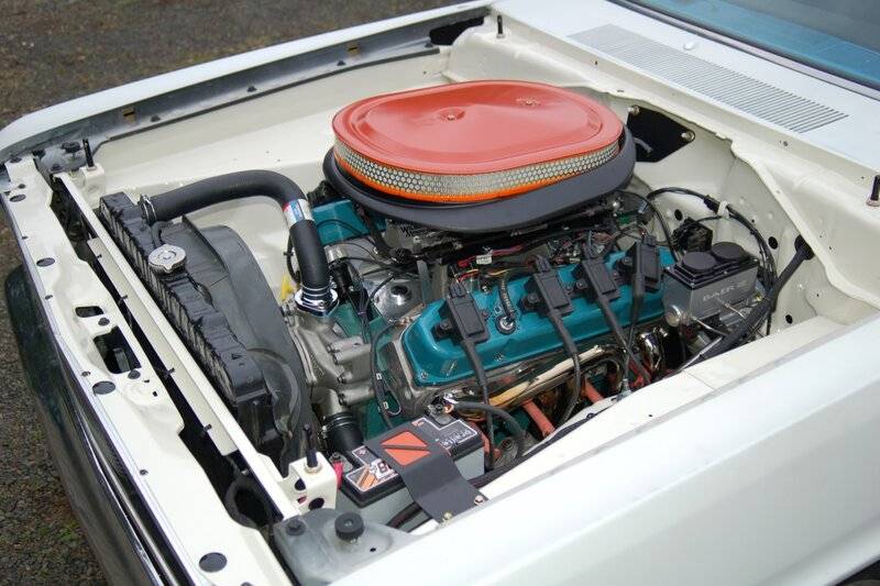

Is it possible to build a 440 A-body with the stock fan?
Don't see why not.. they did it in '67 with the 383 and there's zero difference to a 440.

I also attached a picture of the stock style setup. Mechanical fans and high RPM scare me.
I used a C body radiator when I built my Duster. That combination worked great. Used a clutch fan and a factory shroud. Tried to make it all look stock even though there was nothing stock about it.
