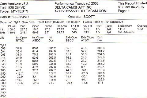

This is the spec's on the cam in my 318(Looks like greek to me! LOL).

Downlad CamQuest you can get a free version it will give you a ballpark number and is fun to play with. Just google CamQuest find a site and downlod it and have fun.
Like 280-290 hp at the crank maybe @6k ?

I would guess 325-350 hp. at the crank. If I can find my dyno software I'll run some numbers. Mike
I'm coming up w/ 326 HP @ 6000 RPM and 322 lbs-ft @ 4500 using Desktop Dyno.
Thanks Guy's I like the sound of 300 + !!! The cam is the one I pulled out of my motor, John at Delta cam said it was an RV cam so he reground it to the spec's you see. Motor has a great sound at idle and is real responsive when I rap on it. One thing I have left to do is get rid of the lock up converter in it. I have a friend who is going to fix that problem when I get around to pulling the tranny out. I have a 1800 rpm stall waiting to go in, but of course it won't fit on the tranny because of the lock up feature.
