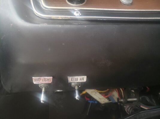

What is thus toggle switch for..? Was it factory..? My dash has one but wasn't wired.
Thanks,
John
Map light switch.
I'm guessing it's not necessary and I could just leave it off..? There was no map light attached anywhere when I removed the dash.
I also don't remember my Demon from way back having the switch or light. I could be wrong though, that was 40 years ago.
No rear defrost on this gem..lol
I thought it may have been for fog lights or something a previous owner just installed.. Them fog lights were kinda popular back in the day.
The map light switch controlled the dome light and/or the courtesy lights under the dash. Same as when you open the door. It’s a ground controlled circuit with a fused constant hot. So if you leave it out make sure to not leave a hot wire just dangling.

“map light”
My 73 Dart has that with a bezel that says”Map Light” in white letters.
At the far right side under the edge of the dash there is/was a black plastic socket that points straight down.
It’s literally for the passenger to read a map, or whatever, and only that light came on when that switch was thrown.
