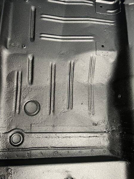

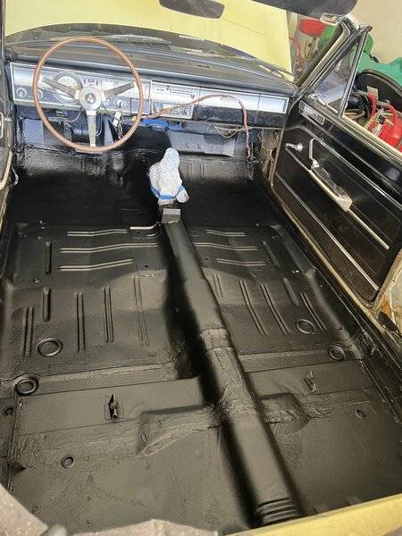

I like the 3M. I tape it and apply with a brush. It looks more factory but without the ragged lines. You can see how it lays out in the attached pictures. The black material is a sound deadener/undercoat material that works pretty well for me.
