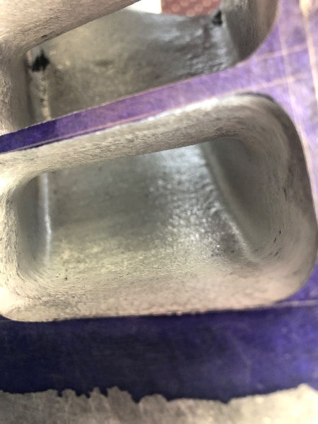

Superformance. No one makes a gasket with this size opening so you have to cut them or they overhang into the ports by a bunch. This was not an easy job, very tedious and time consuming. Make sure you buy an extra set of gaskets, I trashed one. I remember Don/B3422W5 telling me he didn't get involved with this type of thing on his motor and I can see why. I don't recommend it either but I couldn't live with the overhang.
Here's the final fit looking through the intake plenum. I like to think my efforts had a positive effect on performance but I have no way to quantify that.

I just used the 1213 Felpro intake gaskets. There is indeed some overhang, but I talked to several people about it and they all said it wasn’t at all a big deal.
That said, the ports are friggin tall
Yes those are some tall ports. I will get a couple sets of those gaskets. I have both a new super victor and a victor 340. The Victor 340 has been ported by Pittsburgh racer a few years ago. Thanks for the info. What did you paint the inside of your motor with?
Yep! The ports on the BPEs are 2.5” tall x almost 1.2x” wide. I talked to Rod about it specifically and he said oh yeah, you definitely gotta cut the gaskets. You can argue for or against it but it wasn’t a question for me. I probably wouldn’t have bothered with the intake so much if I didn’t care about the overhang.
Fel Pro 1213 and most other intake gaskets are 2.27” x 1.16”. There might be some out there that are 2.3” tall but I wouldn’t bother finding those because you’d still have to cut them and it’s easier to work with more material.

I know Don uses a Victor and he seems to do OK with it but after destroying mine trying to port match it to the heads it became obvious to me that you “need” the Super Victor. The SV has more material on top and the angle of the runners matches up much better. Put them both on and you will see for yourself.
That was another thing Rod confirmed to me directly. He even goes “oh yeah, I thought you knew you needed a Super Victor”! I was like uhhhh no, but thanks for telling me after the fact Bud!
BTW, the newer Super Victor has the port injection bosses cast in and though I didn’t have one to mock up I would bet that those will need to be ground down a bunch if you actually want to install valve covers. My SV is the older one without those and it still required a bunch of grinding. That’s both on the intake side and the valve cover rail. Creating clearance for valve covers is typical with any 'high rise' intake though.
Note the boss at the base of the runner is ground away and also how much you have to take off the valve cover lips to make them fit. Some points required grinding beyond the lip into the rail surface. You can use valve cover spacers for this issue but I chose not to.
Sometimes you gotta do stupid crap like this since no one including Mopar Performance has cared about making life easy for small block Mopar guys since forever.

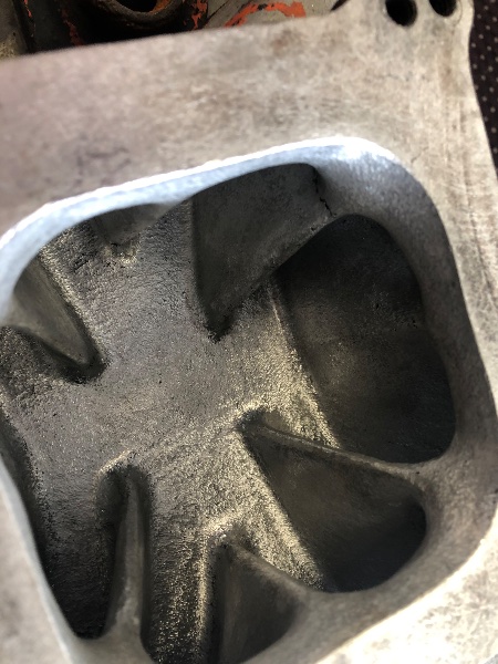

I will admit that I am proud of this intake. I started a thread about it last year, you can read about all my trials and tribulations with it if you're so inclined. Member @Plymouth 65 sold it to me. (thanks Ken). I believe it was originally gasket matched by Hughes some time ago which per Don could very well mean that Vic Bloomer did it when he worked there. I felt bad about grinding on it, it was very nicely done. Red paint is obviously gone.

Probably goes against the grain a little bit, but personally, I don’t think a well done Victor is giving up much power to speak of compared to a super Victor, on these types of motors. I don’t think they have been tested back to back at a track that I know of
My Victor is very nicely ported, and unless the super Victor is done to the same level of care, they can actually be duds.
That plenum is friggin huge on the super. I would love do a direct swap and look at both time slips, I don’t suspect there would be enough difference to raise an eyebrow.
This is my intake after it was done
