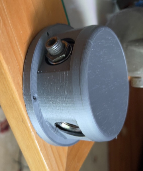

I am making some coil pack valve cover spacers for a friend this morning to try out a new filament (PAHT-CF) and I was wondering what filament everyone else was using for engine parts.
Before I tried PLA-CF but I made a few things out of it and they warped at like 140 degrees sitting in my truck in the parking lot at work. (apparently not as heat resistant as advertised) I want to try polycarbonate but I was just wondering if anyone else out there has had any success with any other types.
