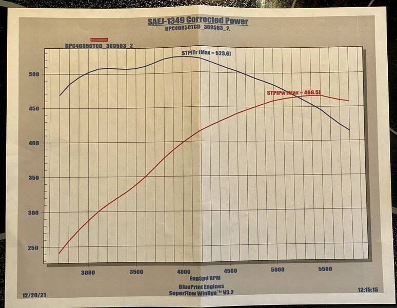

My current engine is a Blueprint 408 stroker making about 460 at the crank driving an A833 4spd with stock ratios. There's more than enough power to overwhelm the tires in almost any gear...at least with my 255 no-season BFG T/As.
Would it be more fun with 3.23s or 3.55s? I just don't know and experimenting is outside of my budget currently... I'm hoping to learn from you guys before I invest.
If your stroker has been dyno'd can you post the results. That will tell you what gear you need depending on how you are going to use it.
Yeah. It came with a dyno sheet. I will try to get a picture up this evening. Thanks!
