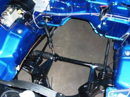

Might want to pm bob shingler, I believe he has a rack in his car with the factory k-frame.....
http://www.forabodiesonly.com/mopar/showthread.php?t=12203&highlight=rack+pinion&page=3
Post no50 is the sort of thing....................
attachment.php
