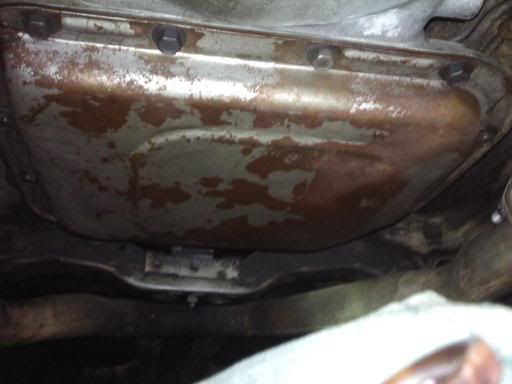

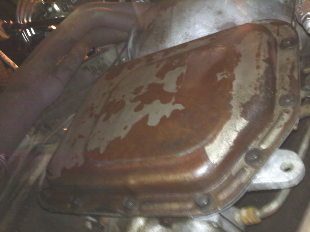

hello. i have a 68 cuda fastback. originally came with a 318, and 489 case 8 3/4 rear. how do i tell what tranny it has by looking at it underneath the car?? 727 or 904?? are there a different number of bolts on the pan? i cant find any numbers on it from what i can see...

i thot that the 489 didn't come out till the 70's? and my guess would be a 904, unless it was a hipo 318...
727 pan has a bump on it. 904 is more or less square. 727 pan pic is attached.

That 904 is for the 68 cuda that has a 318. It will stay a 318 too, I'm just gonna put an edelbrock performer on it, with comp cams pro magnum roller rocker arms on it...Think that's all I'ma do to the motor...

904 will have a small yoke...
Both the 727 and 904 can use either the small of big yoke. I've seen them both ways.
