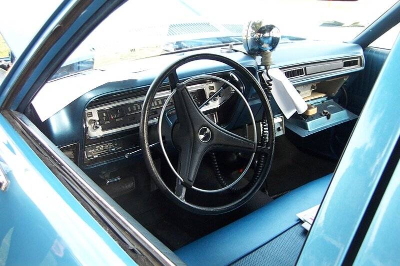

What materials do I need to convert from a rim-blow wheel to a "partial horn ring" wheel?
The rim blow wheel on my 1970 Dart Swinger is cracked/ and non-working and just all-around gross and nasty. I love the look of the S-79 partial horn ring wheel and would like to convert to that. My understanding is that it's a 1970-only wheel and can fit all A-, B- and C-body cars. **Is this correct?** (I know that earlier years has narrower columns that are a no-go).
I have seen the S-79 wheels for sale on ebay and all for really high prices, and i also see just the center horn pad part. The wheel rim itself is available as a reproduction which is fine with me, but it says in the ads "Use existing hardware to mount". So I guess my next questions are, do the rim-blow wheels use the same mounting hardware as the S-79 wheels? If not, is there a mounting kit for stock wheels I need to buy?
Being the relative noob that I am, I need to know the complete list of stuff I would need for the conversion, so I come hat-in-hand to ask you, the A-body experts!
Any suggestions? Thank you in advance!
Since it fits this thread, how would I go about removing the middle wheel in that picture?

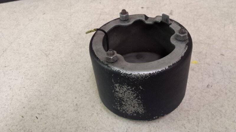

The Rimblow and Tuff wheels use the A/B adapter which is not used on the S79 wheel. S79 goes right onto the column. You will need 1970-up S79 wheel as 69 is different. I say up because it was also used on 71-4 cop cars.
Pic of the adapter.
Pic of the adapter.

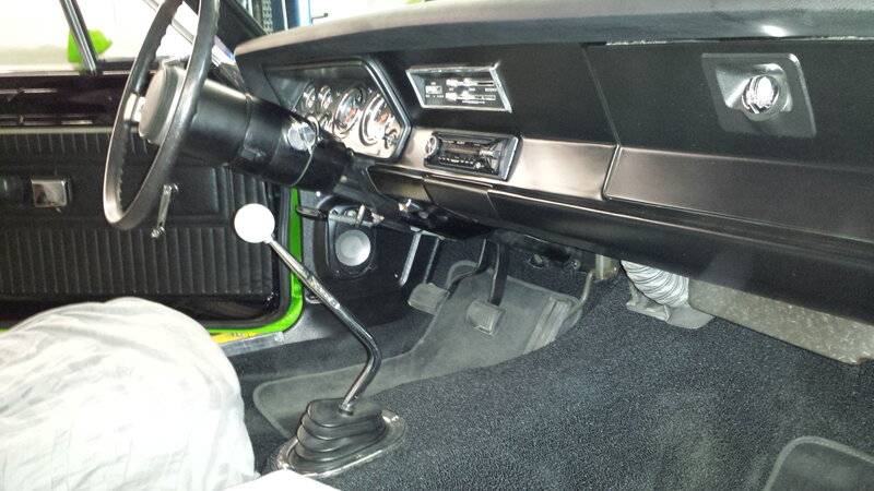

Here is the best image I have on hand of the steering column. Is that "A/B" adapter internal where I cant see it?

No, I'm saying that the S79 does not use the A/B adapter. The Rimblow does.
When you get an S79 wheel you need to be sure that you get it's mounting hardware that I've shown in my picture.
The adapter is external and makes the column about 4" longer. Rimblow, Tuff and E body wheels are flatter than the 3 spoke wheels.
I see what you're saying, but mine doesn't seem to have that round adapter between the steering wheel and the column like yours does, if you look at the picture I posted above in post #7. Are we talking about the same style "rim-blow" wheel?
Okay I follow ya. Sorry, no different Rim blow. I forgot about the you that have a was thinking about this one.
Post 10 does not show a rim blow.
Might help to post a pic of yours.

A- If your wheel does have the "can" like a "tuff wheel" does (post 10) remove the three nuts before you can access the large nut (step 2).
On a tuff wheel, the horn spring retainer comes off with the wheel (step A).

Ya S83 shown in the 1st post is that weird one year only rim blow. Not the wood grain style.

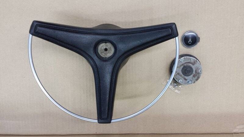

Yes they mount the same. Just be sure you get the mounting hardware and horn switch with the S79 wheel that I showed.
I also think you need the S79 horn switch - it is the tilting of the switch, byt pushing on the horn ring that blows the horn. On a 70 rim blow nothing tilts so I think the horn switch is different. If you get stuck send a pm and I'll take a pic of the correct s-79 horn switch and you can compare with the one on your rim blow.

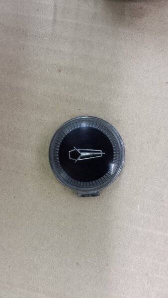

There is a plate with a bolt that is specific to this horn pad. See my picture. Doubt that anyone makes it so you need to be sure it is included with the setup that you buy. The steering wheel mounts to the column with the nut just like most any other wheel including your S83 wheel. Then the horn switch is screwed to the wheel. Then the plate is screwed to the horn switch. Then the horn pad is bolted to the plate. Then the emblem plate snaps into the horn pan hiding the bolt. Vala.
Ok I think I understand. The "plate" you're talking about is the silver-ish looking round metal plate in your photo in post 6. I will keep an eye out for that before buying any wheel I see for sale. Thanks!
