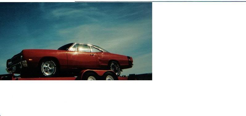

I have personally seen a 69' 440-4speed pinion snubbed Super Bee with 295/50/15 Dunlop GT Qualifiers hook it up pretty good....good enough to slip the tire 8" around the rim from its original location at 32 psi. To the best of my knowledge...that cannot happen when they are burning/slipping.
Btw...same Super Bee went 1.8 60' ft, 12.37 @ 117 on those GT Qualifiers

I'm impressed. I didn't have the same luck yesterday. But I didn't warm the tires up either. Could that be the difference? I was always under the impression that the street radial just wasn't the best hooking tire.
BTW...that is a very nice looking Bee.
The Dunlops seem to be working pretty good on my Duster. What do you have running in the way of rear suspension mods?
