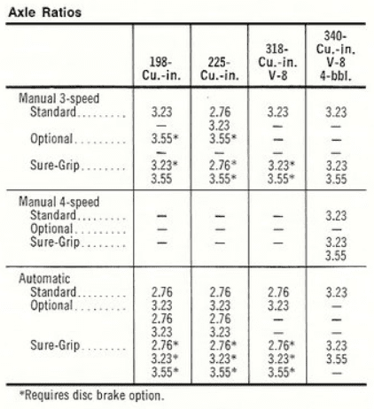

Yes. But it had to be /6 car with standard drum brakes. If you got your /6 with a sure grip, or 3.55 gears, that triggered front disk brakes. Same for the optional towing package, you could get a /6 with a towing package, but it would have disk brakes!
These are from the '73 Dealership Data book, courtesy Hamtramck Historical The 1970 Hamtramck Registry - 1973 Dodge Dealership Data Book - Dart
