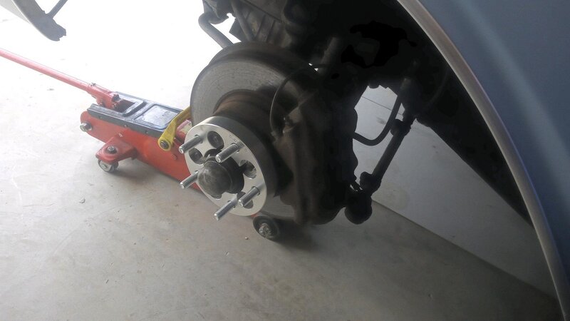

Two years ago, I installed a set of four 1" billet alloy adapters/spacers on my Demon and so far no problem.
Converting my hubs from SBP to BBP, this set allowed me to install magnum wheels.
But my Demon is a slanty, so not very powerful :)
