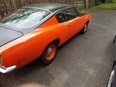

I have 15x8 4.25 backspace cragars on my 69 cuda rear with 235-15 tires. My car sits pretty high in the back. They fit well with extra room. I probably could have gone to a 245 with no issue. My suspension is stock except for ss type leaf springs.
Mike
Thanks for the response, I have now 275 x 60 x 15 in the rest now, with stock stellies (i believe they are 15 x 7 inches) but what I was concerned with is if 15 x 8 rims will fit with 4.5 inch backspace.

I'm running a 15x8 with 4.5" BS (275/60-15) on the back of my 68 Barracuda with no problem (Stock suspension)...all things being equal, you should be fine.
275/60/15's on a 10" wide with 3-1/2" BS. All stock HD leaf at stock location and the standard 10" X 1-3/4" brakes. Inner fender lip would still be an issue for this tire even with a 4-1/2" BS rim.
IMO, 15" X 8" with 4-1/2" BS works as long as no old school T-bars are used. Not sure about spring clamps.
