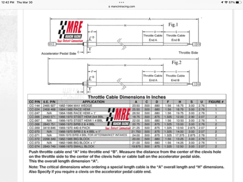

Ok, so finally removed my throttle cable...should have done that 1st to get accurate measurements. I am assuming this is 67 sb 4bl meaurents.
See pics for dimensions also.
Overall length 18"
Clevis end to end of metal crimped jacket 7 1/2"
Length of black jacket only 9"
Length from start of jacket to metal flange for firewall 9 1/2"
So overall length needs to be approx 16"
Black jacket length approx 7"
I believe the length from.clevis end to end of metal crimped jacket stays at 7 1/2".

Did you try the 17.5”? I just found out it won’t work for me on my 383 and DP4B. Too short by at least an inch.
Yeah the dimensions on one I got were different in a few places. My bad, I should have measured in beginning.
Theres more to it then just overall length.(that's what she said :lol: )

News to me too, I figured BB A body would need a special cable but it seems like it’s the same as SB if not a little longer for a taller intake/spacer combo.
