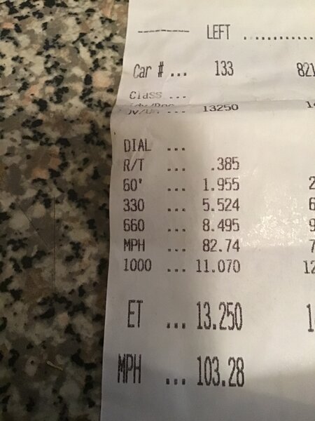

Time slip. Thinking of trying a 80/20 front drag shock like the ones @318willrun has. I have summit headers that hang low but my suspension is higher up front with a 205 70 14 front tire. I also have open gears and traction bars
Couldn't tell by the video, too far away. Are you spinning? Didn't seem like it. You gained 21 mph in the last 1/8, so maybe not enough converter for the cam you are using? That would make the MPH higher for the ET ran. Overall, the ET slip isn't bad from start to finish for a street car. They usually do MPH high for the ET
I had a fuel starvation issue on the top end, but it’s been fixed now. So the next time the car hits the cars I’m pretty sure I’ll be in the mid 12s.
The car hooks great out of the 5 times I raced, only 1 time I had some tire spin.
