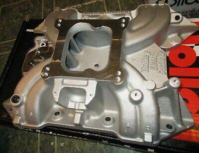

A stock six-barrel setup will fit under a stock hood!
I run a Holley Street Dominator, pretty good intake for pretty wide range of builds. No clearance issues, my Eddy RPM gets pretty tight and required a drop base air cleaner.
