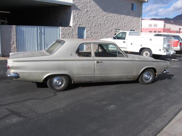

Check Las Vegas or Phoenix craigs list. There was a 64 convert not too long ago. It has been for sale for a while and pops up every few months. The one in Phoenix had a real nice body and I think ran and drove, but the top and interior was toast. I think the price was around 2K. If you are serious you can make a deal. I got my 2 door post 64 for $1800. He wanted $3500. When I went to look at it I had the money and trailer with me. The car was all there nothing missing and was driveable. The worst part of buying out here is how to get it home. Shipping costs a fortune. I have one guy that comes out from PA that buys a truck,trailer and the car he found,takes them back east then sales the rig for cost or he makes a few bucks and the transport of the car is just his time and fuel. Just a thought.
