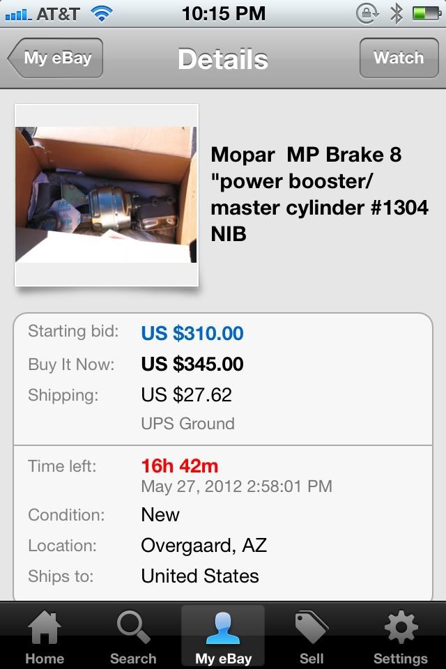

The rest are from $275 to $300

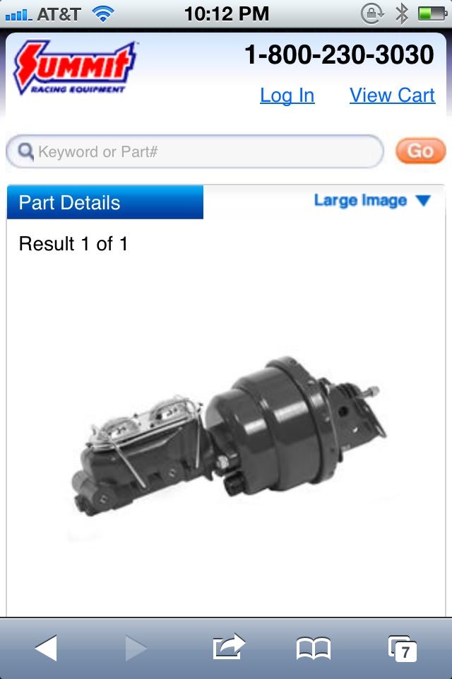

Don't get the Summit one if it looks like the photo, since for GM (don't you hate those "representative photo"). Note the tilted bracket and threaded rod. GM had a strange design where the same brake pedal was used for manual and power, with holes at different heights (for different lever ratios), hence they had to tilt the booster.

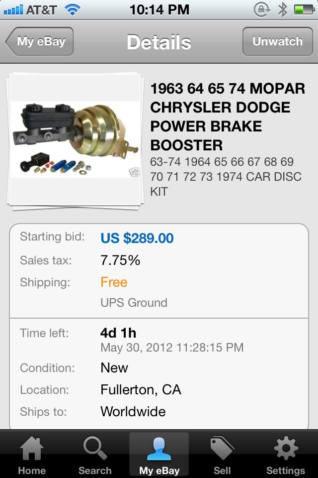

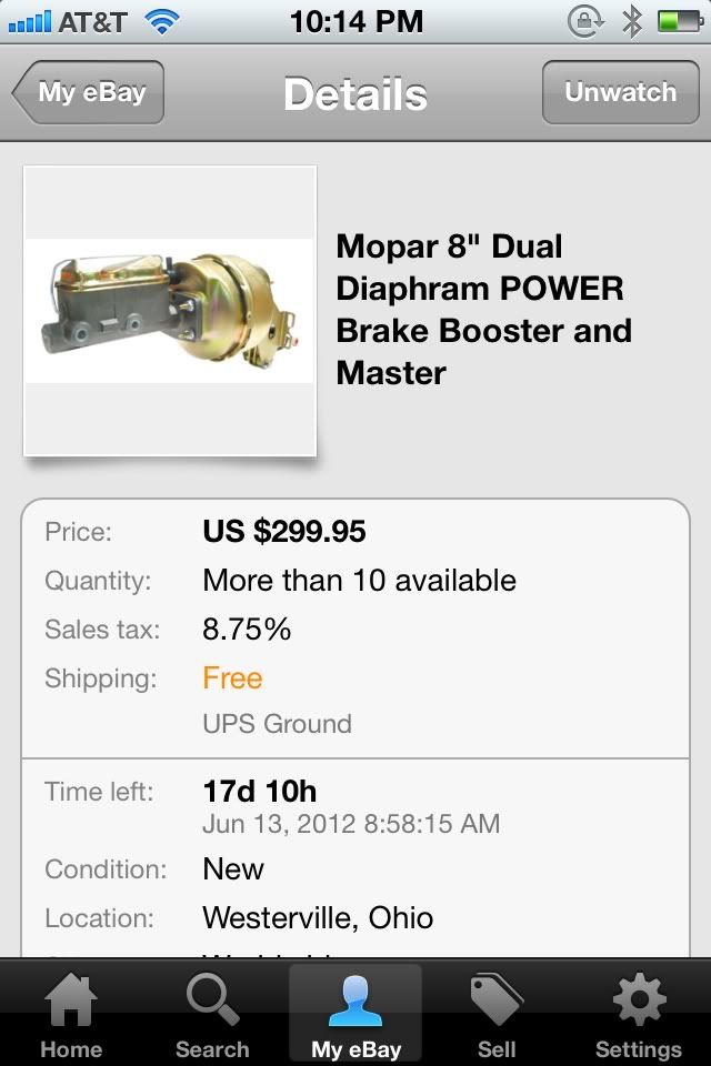

I would get the $289 one and it comes with an adjustable proportioning valve (probably don't need the residual valves shown). It is also a double-diaphragm booster (as is MP one, $300 one looks like a single). The others have heavy cast-iron MC's, and who needs that. You can get the 2-hole alum MC at any auto parts (have read it is used on 90's Dodge trucks).

Nice. A dual-diaphragm booster. Only thing is it looks like it has a factory style proportioning valve, instead of an adjustable one. Probably fine if your brakes are close to standard. At least you won't always be bothered wondering if you adjusted yours right.
