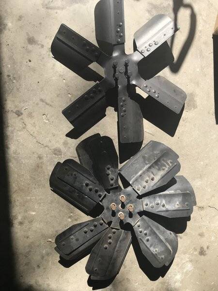

go-fish FABO Gold Member FABO Gold Member Joined May 20, 2010 Messages 2,761 Reaction score 4,454 Location Okla. Mar 11, 2022 #1 One is a Derale and one is the one that came on my truck. I will also be using a Hayden HD / Truck fan clutch. Radiator is a stock replacement heavy duty.
Professor Fate Push the button, Max... Joined Jan 13, 2020 Messages 6,591 Reaction score 11,544 Location Wisconsin Mar 11, 2022 #2 All the clutch type fans I've seen have the large center hole and bolt pattern? Yours look like straight mechanical fans.
Dubob FABO Gold Member FABO Gold Member Joined Oct 28, 2011 Messages 1,409 Reaction score 741 Location Ohio Mar 11, 2022 #3 Neither one will work with a clutch drive. Both are direct drive. Clutch drive has a much larger center opening.
Garrett Ellison Amateur driver on public roadway, do not imitate.. FABO Gold Member Joined Jan 1, 2018 Messages 5,627 Reaction score 5,201 Location Southwest VA Mar 11, 2022 #4 What year and engine of truck?
44070dart How the hell did I get this old.. Joined Jul 9, 2004 Messages 2,891 Reaction score 5,044 Location right here ...see me I'm waving.. NY Mar 11, 2022 #5 Go electric
Rat Bastid Dunamis Metron Joined Nov 23, 2020 Messages 4,900 Reaction score 5,508 Location 22 The Avenue Mar 11, 2022 #6 The top one.
go-fish FABO Gold Member FABO Gold Member Joined May 20, 2010 Messages 2,761 Reaction score 4,454 Location Okla. Mar 11, 2022 #7 Doh! Thanks for pointing out the hole size. The truck is a 76 D100 318. Gotta get a new fan AND clutch
Rat Bastid Dunamis Metron Joined Nov 23, 2020 Messages 4,900 Reaction score 5,508 Location 22 The Avenue Mar 11, 2022 #8 go-fish said: Doh! Thanks for pointing out the hole size. The truck is a 76 D100 318. Gotta get a new fan AND clutch Click to expand... Skip the clutch fan. Use the one on top and send it.
