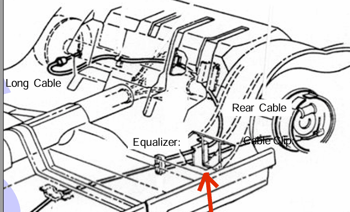

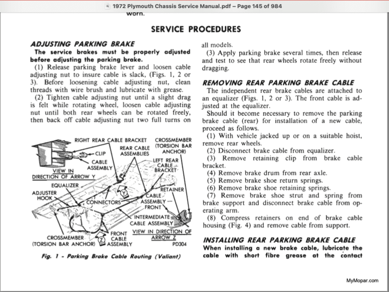

Can someone tell me whether my 1971 340 Duster has the parking brake kit with an Intermediate cable, or without? The cables under the car are missing - so I cannot see what it had. Just trying to figure out what kit to order, or how to identify which kit it originally had.
Thank you!
Maybe the cable mounts on the vehicle can give you a clue of the routing.
My '69 has both on the driver side forward of the left rear wheel.
You guys are awesome, always ready to help a fellow member.......
Thank you all for the replies. This Duster is new to me, and i have only had it for about 6 weeks. It is just a rough looking driver, but pretty original. I am just going through the little stuff it needs to be a reliable cruiser. A previous owner converted the whole car to the big bolt pattern, which is cool with me. However, i am guessing that when they did that, they didnt address the parking brake cable length differences. I will put it up on the lift this weekend and see if it has the two cable mount bracket on the drivers frame rail or not.
Just to close the loop on this: I got under the car and found that it is the type with the intermediate cable.
