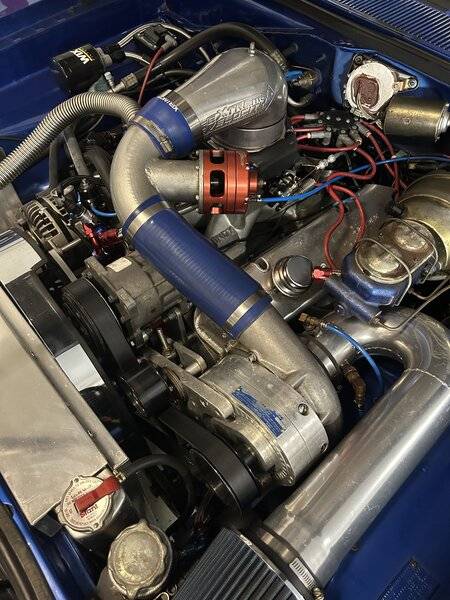

Hello Everyone,
I have a 1967 Barracuda that I've owned since I was 17 (I'm 58 now). It currently has an 850hp, F1 Procharged small block (R3). It's back halved with a 10 point roll cage. It's a street car with Gearvendors OD, PS, PB and AC.

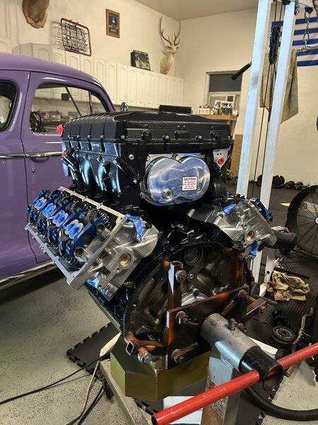

I originally built this Gen3 Hemi for a 1948 Plymouth coupe. But as I look at it on the engine stand, ready to roll, I got to thinking that I didn't want to wait another year or two to get the coupe ready to handle that kind of power. So I got the great idea as I looked over at my Barracuda and said "F" it.... I think that Hemi would be awesome in my Barracuda and it's already set up to handle the extra ponies that this Hemi will pump out.
Am I nuts? The current set up runs great, but the old hot rodder in me just can't leave well enough alone...lol.

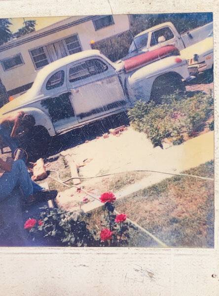

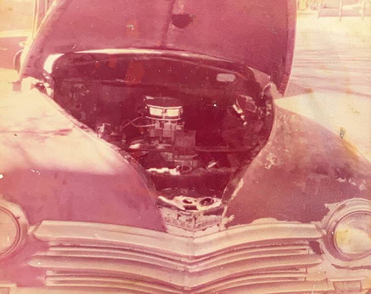

That’s funny, I also had a 47 Plymouth coupe when I was a kid. Actually even before I got the Barracuda. I was like 15. I was building a 354 Hemi with dual quads but didn’t have the money, tools or skill back then.

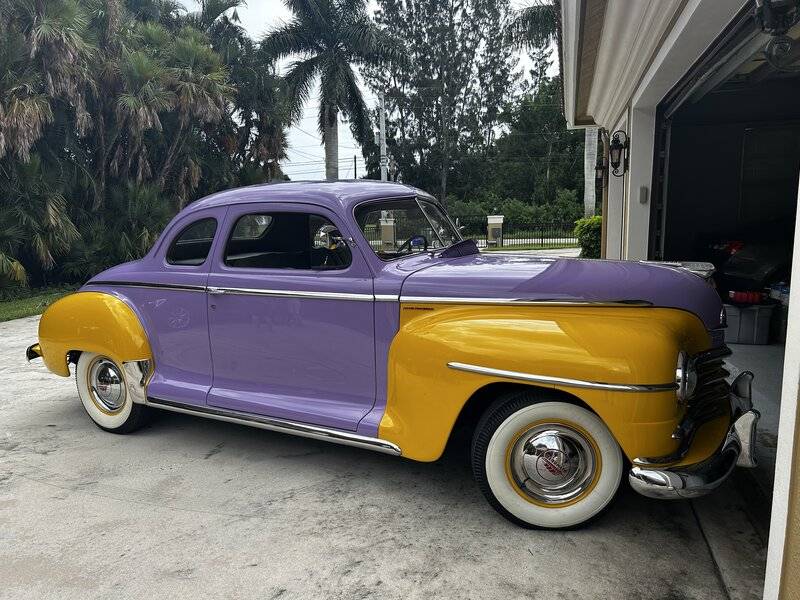

Which is why I bought the 1948 Coupe. To finish that project I never did when I was a kid. Except this time with a modern twist, a Gen 3 Hemi. It’s been on my bucket list!
Here is the one I had when I was a kid. That’s me as a scrawny long haired teenager working on it.

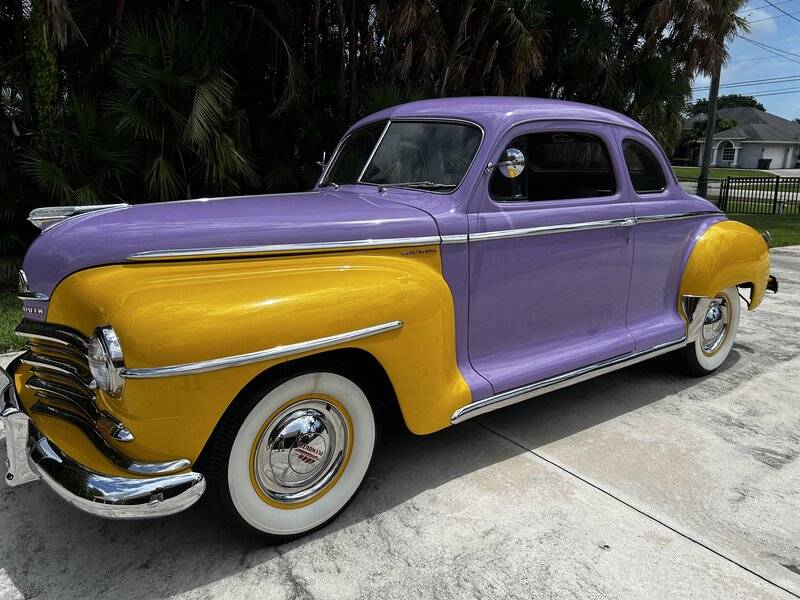

And here’s the 1948 that I’ll be building. Don’t laugh at the paint. It was like that when I got it. Someone did a full frame off resto back in 1998. Supposedly it was for the guys 50th LSU reunion, hence to purple and yellow and why he did a 1948.
But the car is very solid. Has perfect original chrome, dash. It’s like driving in a time capsule. Every nut and bolt and washer is almost like new. I almost hate to cut it up. But the 95HP flathead six bores me.

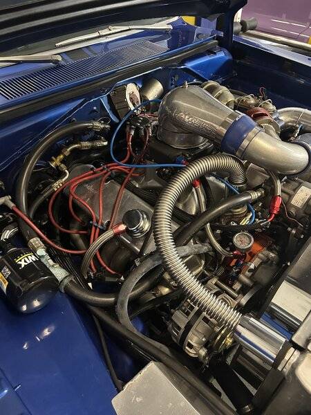

Let’s see the R3 pro charged engine currently in the car. How much power does the Whippled hemi make?
The Hemi should be about 1100hp pretty easily. I could turn it up to 1400+ on E85.
I built it like a tank. It’s a BGE block and heads, with a Manley Stoker forged Kit including the H-Tuff Rods, extreme duty pistons (9.5 to 1) an CamMotion custom ground cam and Arrington Billet main caps just for good measure. It should be able to handle anything I can throw at it.
