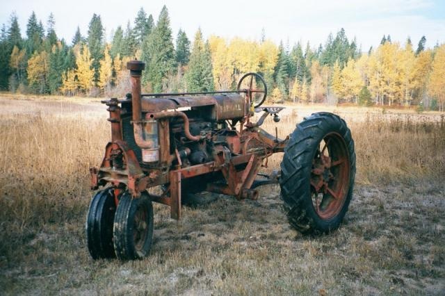

This is the old Farmall "Regular" the day I sold it for Mom. We DROVE it onto the trailer. That thing is a "man's" tractor. When I first started dealing with it at 13 or 14, I used to scoot forward on the seat and clamp my thighs around the wheel to keep from "losing" it.
