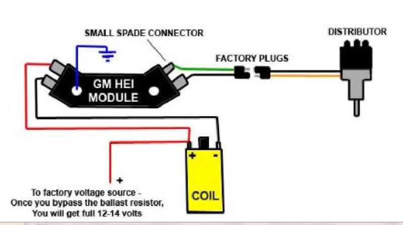

It all wires up like this:

Of course you need the Straight 12 volt wired E-Coil
