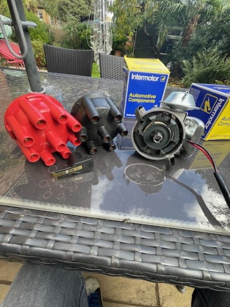

it arrived well packed in a in triple thickness sealed plain box
its a six cylinder distributor but they (the seller or manufacturer) appear to have accidentally put a V8 cap on it.... first failure
to try it out i needed a Cap but no way was i going to pay £36 shipping and import of a $19 cap for a distributor that could be scrap out of the box.... so a solution needed to be found
Research followed

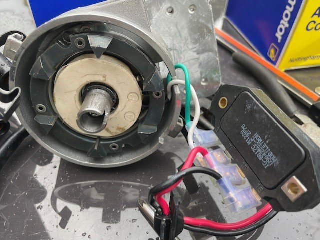

first impressions

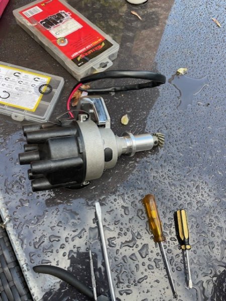

Nice well machined casting with good fit into the bore of my spare engine block
the black nylon gear engages well.
shaft is same size as slant.
the shaft appears to ride on bearings in the head and standard bushes in the base

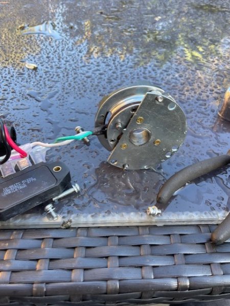

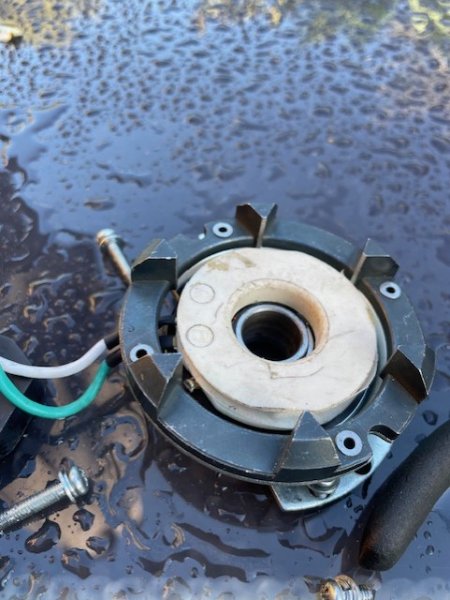

the pickup and reluctor are robust
there is nothing new or innovative about the advance armature apart from instead of a snap ring it is held on with a cross head threaded bolt and lock washer under the rotor.

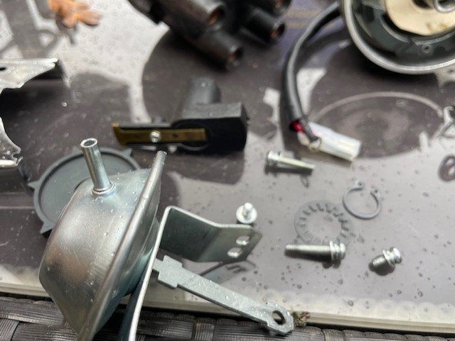

the vacuum advance pod arm was at an angle which meant you could unlatch it from the advance mechanism by twisting the advance plate. it worked to advance the plate but could be disconnected by twisting it back, but i want it to stay engaged. ham fisted assembly by the look of things

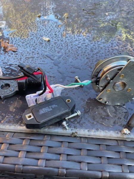

The wires from the pickup are solidly mounted and flexible in soft insulation, wire follows a sensible route.

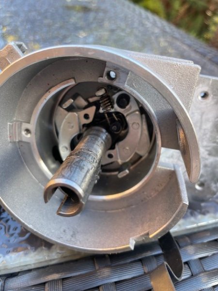

the advance mechanism follows the bosch style. swing out weights driving the rotor armature round with a standard spring and a long loop spring
the weight stops are pressed metal poles that can be bent in or out to adjust max mechanical advance
the weights have plastic bushes and a plastic foot.

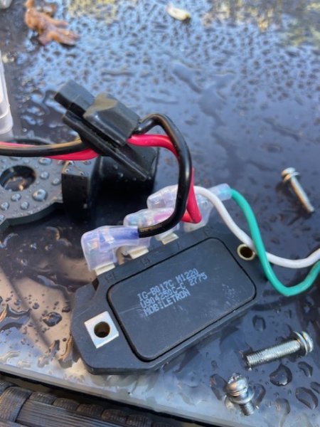

the module is a generic copy of an australian bosch module
on the whole not bad apart from the 2 failures noted previously.
to fix the engagement of the vacuum advance i made a very slight bend in the arm and now it stays engaged all the time
the vacuum can is fully activated at 12 "Hg

The ignition module is an Australian Bosch BIM024 or a chinese copy which does the same job as a Delco 4 pin HEI module. its just a different shaped case, apply the same common sense, if there is no name on the box and no name or part number on the module i'd pay more and get one where the manufacturer is not embarrassed by their product.
So if you were willing to put in the time and effort you could probably make one of these work well, you can replace generic chinese stuff with branded parts or even original bosch parts if lucky enough to find them at sensible prices
spare parts that i presume to be of generic chinese origin can be had from australian suppliers and Jegs and possibly Nickels performance in the US
there is potentially still Australian/AP genuine Bosch production of caps and rotors that fit and if not a number of local suppliers produce equivalents FuelMiser etc.
If push comes to shove, as in my case, there has been UK manufacture support in the past
You could use a GM 4 pin HEI module where the bosch BIM024 sits if you don't use the metal cover

Sorry photo are a bit crap..nice sunny 63F day until it rained a weeks worth in 5 minutes
1) V8 cap and I6 cap, same size, the red one is just closer and got fish-eyed by my old phone camera.
2) Pickup in place needs to be properly centred, metric allen headed bolts with split/spring lock washers.
3) Rotor and reluctor removed, reluctor sits on a non standard sized circlip/snap ring, with holes so small your snap ring or clirclip pliers are useless, and is held down with a spring washer and a standard size circlip/snap ring, you can see the non standard lower circlip/snap ring in place down the centre of the pickup. not easy to get out, jewelers screwdrivers and a fight.
4) Vacuum can off.
5) it rained, got a rainbow on top of a rainbow! with a rainbow above.....strange weather.. i had to hide with the barbeque till it passed
6) module and wiring. see stud under main pickup ring for the vacuum advance connection. no circlip.
7) pickup coil solid plastic spool with tape
8) module part number and brand (oh.... same as some 4 pin HEI, that come in boxes with the name xxxxxTron) Mobiletron Electronics CO., LTD.
9) advance mechanism plastic foot and plastic bush for weights, metal, pressed weight stop pillars on the periphery.

1) pickup can go on in two positions one for V8 and one for I6. put it in the wrong place the phasing will be off and you would need to use a different shorter arm vacuum can.
2) pickup needs to be centred, do it now so you can twist advance to check no touching between reluctor and pickup points in all advance positions.
4) asememble pickup, put on the on the non standard circlip in the bottom position place the reluctor star on, then clamp it down with the spring washer and standard circlip. Now position your pickup whilst the vacuum advance is still disconnected. do up screws use screw driver to move pickup to achieve centering. do screws up tight and check.
spend some time getting the eye of the vacuum can linkage back onto the stud do up screws

left upper circlip for above the reluctor star
far far right, the spring washer for on top of the reluctor star
middle the, tiny-hole, non standard circlip for below the resultor star
right a stretched standard clip just to see if i could keep it functioning if i broke the none standard clip... reasonably successful given my lack of imperial sizes 3 metric boxes found around the place, no imperial
