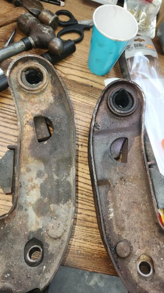

My Dart went from bump steer a little to 2 hands on the wheel in the span of about 2500 km. I've put about 6000 on it this year. When I built the car, I didn't look at the LCA bushings as they felt tight. Tight or not, they weren't healthy. It's getting a set of BAC pivot pins and delrin bushings now so I should be good for a long while hopefully

Then you need adjustable strut rods.
I’m working on a car that I rebuilt the front end probably in 2019. It probably doesn’t have 1500 miles on it.
The rubber LCA bushings and strut rod bushings are already junk.
Because I didn’t make him use poly or delrin and adjustable strut rods I’m going to have to do it again.
And this time while I’m in there I’m **** canning the the worthless spool mount K member.
This will never do another without upgraded bushings and adjustable strut rods.
If the customer won’t do it he can move along.

Adjustable strut rods are in the future plans. For now, the old ones are going back in with new bushings so I can finish out the season

damn that blows. when i pulled the lower arms from our dart apart to put delrin bushings in last year, the rubber was still like brand new and i put them in like 12 years ago.. kinda felt stupid for pulling it all apart..lol
I was going to say maybe the cold, wet winters are what got after the rubber so quickly but then I saw you are in NJ and your winters certainly aren’t Florida winters lol so I can scratch that one off the list of why the rubber has crapped out.
well it doesn't get driven in any of that weather.. has always sat in a tent or garage so i'm sure that helps.
