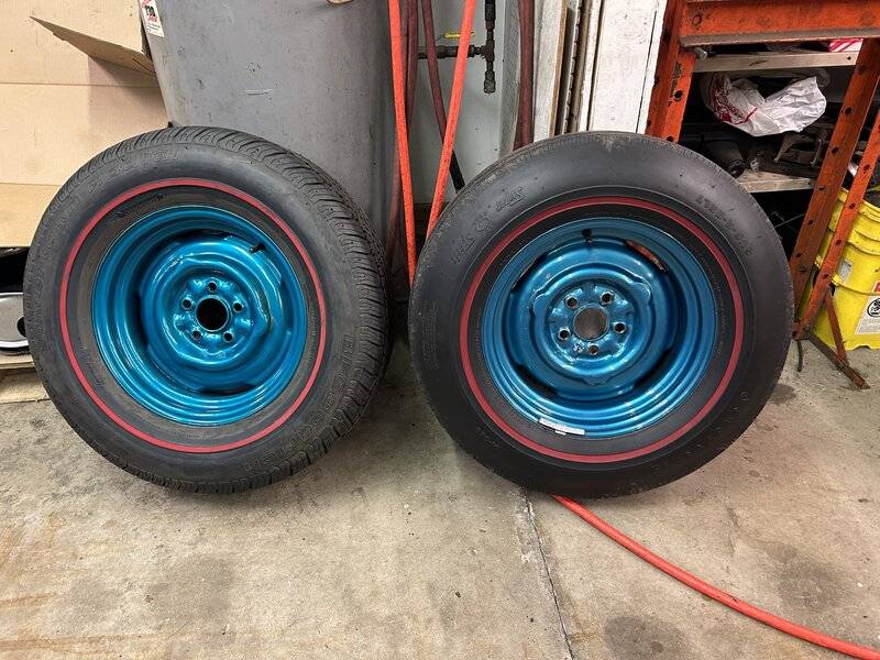

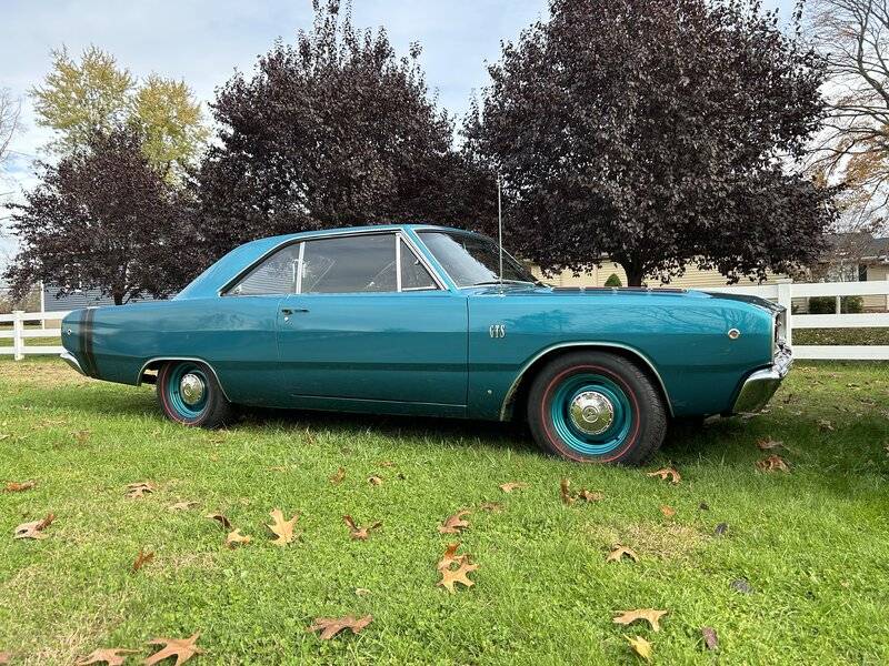

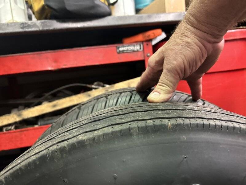

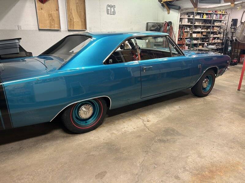

No fitment issues with quite a few road miles. 225/70/14 redline radials on stock 14x5.5 wheels. Some photos of a comparison with the E70-14 bias ply stock tires and same size wheels.
