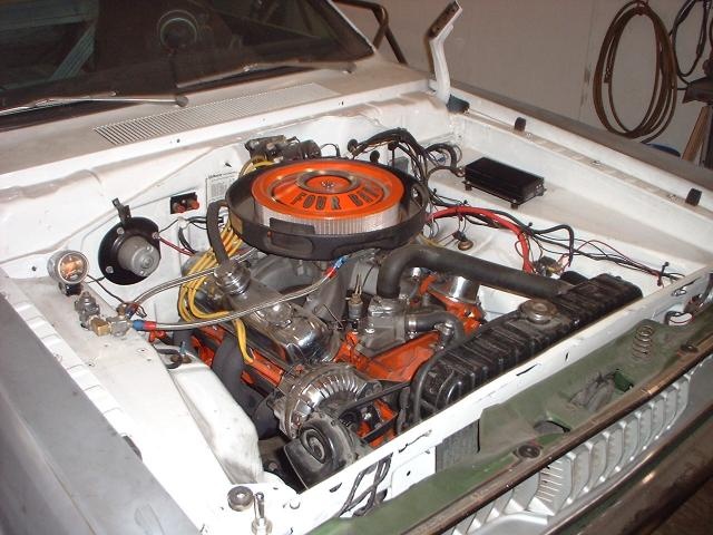

I think I would throw that braided steel radiator hose as far as I could. Radiator hoses are 2" id for a reason. You need flow!
Take one of them big fans that blow air and chunk it in front at idle parked...if it stays hot, then you can cross off airflow and look at flow...just an idea...and cheap.
This is a moroso set up same hoses run on our modifieds and sprint cars and never a problem. You only need 1 inch diameter same size as the stat flow. I had the factory hose on the upper and the lower is still on. It didn't make a difference. The biggest difference so far was getting the air out with the bleeder in the pump.
