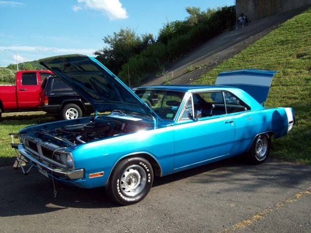

that's a 225/60R15 with 15x7 4.125 backspacing. Its tight but it fits without rubbing.
