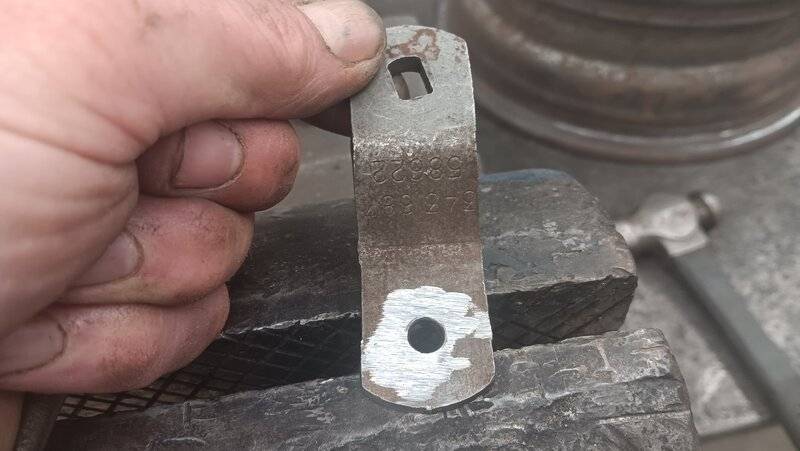

recently bought a 1974 Plymouth Scamp and all the wiper bushings are missing. they seem to be an odd size. the pins measure .373 and the holes in the linkage are .545. I have tried 2 different sets from online vendors and they fit the linkage arms but not the pins. they both measure about .030 too small. tried doorman 49439 and they are for a .608 hole in the wiper linkage arms,,, help. this car has 3 speed wipers.

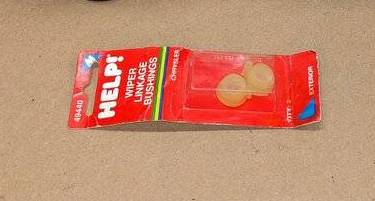

The Dorman, or Help!, number for the bushings is 49440.

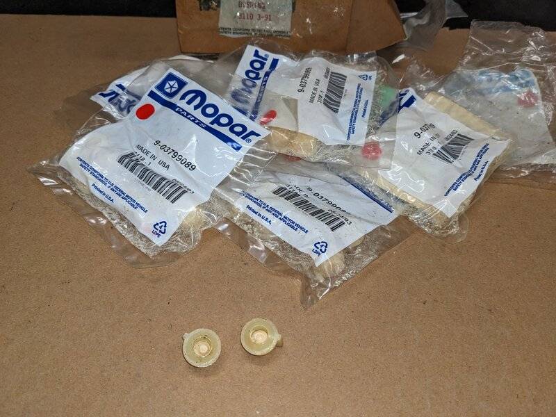

the ones in ordered on Ebay says they are the 3799089 part number, they came in a single zip bag. they are not even close to working. I will try and find actual Mopar ones this time.

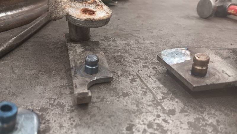

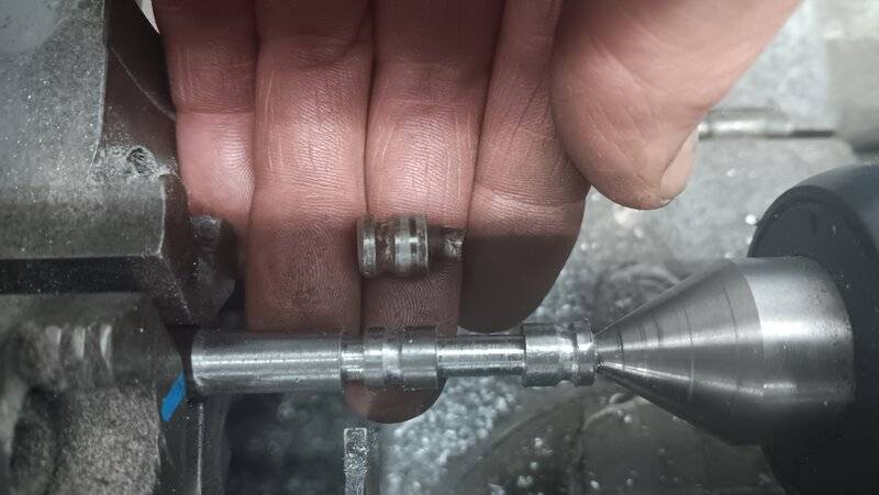

the doorman 49440 are the same as all the others I have tried. the Mopar 3799089,, same deal. they fit the linkage arms but have ,030 of interference fit,, they are locked on the pins. anyone else have any ideas before I waste a day machining up some different pins and tig welding them.
