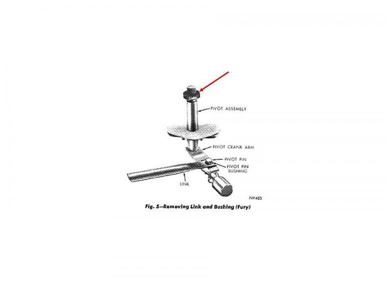

Not to hijack this thread, but I have both my wiper pivots out and want to replace the seals (red arrow in pic). Where can I find something like this?
