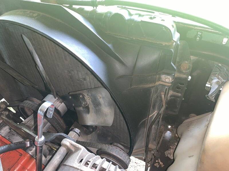

So, it ended up fitting, but pretty tightly and I had trouble getting the shroud back on. It sounds like quite a few just skip on the shroud, so I'm gonna try it for now. Thanks for providing your experience with it man.
