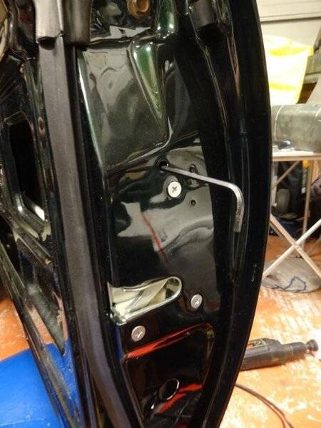

All it might need is the latch adjusted in or out or up/down just a bit.
Another thread with some ideas…
Door sticks
And a door latch adjustment…
Yup!
It could be that easy.
No way to know without some more info though.
Moving the latch does not fix a worn hinge pin problem if that's the cause.

First reference is Something you should have in your Garage.
The Factory Service Manual for your car.
There are free downloads available.
Here are some reprints for an A-body.

65 dartman is correct about the adjustment but don't do it until you have determined if your hinges are good or need to be repaired/replaced. If the hinges are bad it will be a temporary fix at best.
Remember, this is also a safety issue and adjusting a door latch incorrectly can affect how well it stays closed. That's why you need to determine what's wrong first.
OK... sounds good. Thanks for clarifying.
