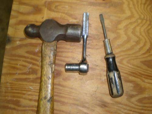

Here's a new and easier way to remove/install the spring on the clutch pedal. ......Note this only works with the pedal assembly out of the car...... This method requires only three tools: a hammer, flat head screw driver, and a 7/16 socket.
